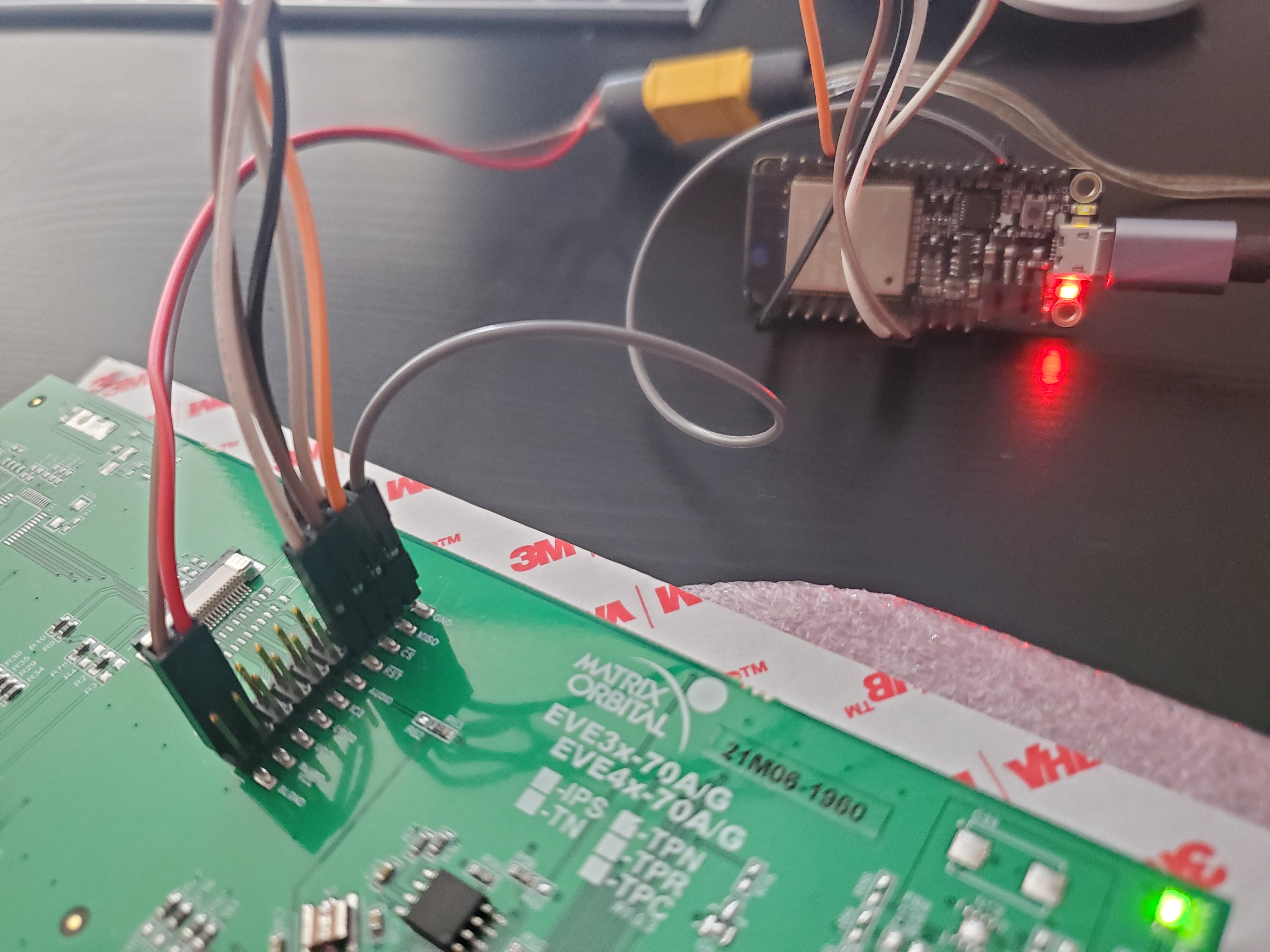

I have previously worked with an EVE3 5" display connected to an ESP32 micro-controller. The 5" was working well but when I tried to replicate the connections and code (with parameters changed) on the EVE4 7", I am not getting a working display.

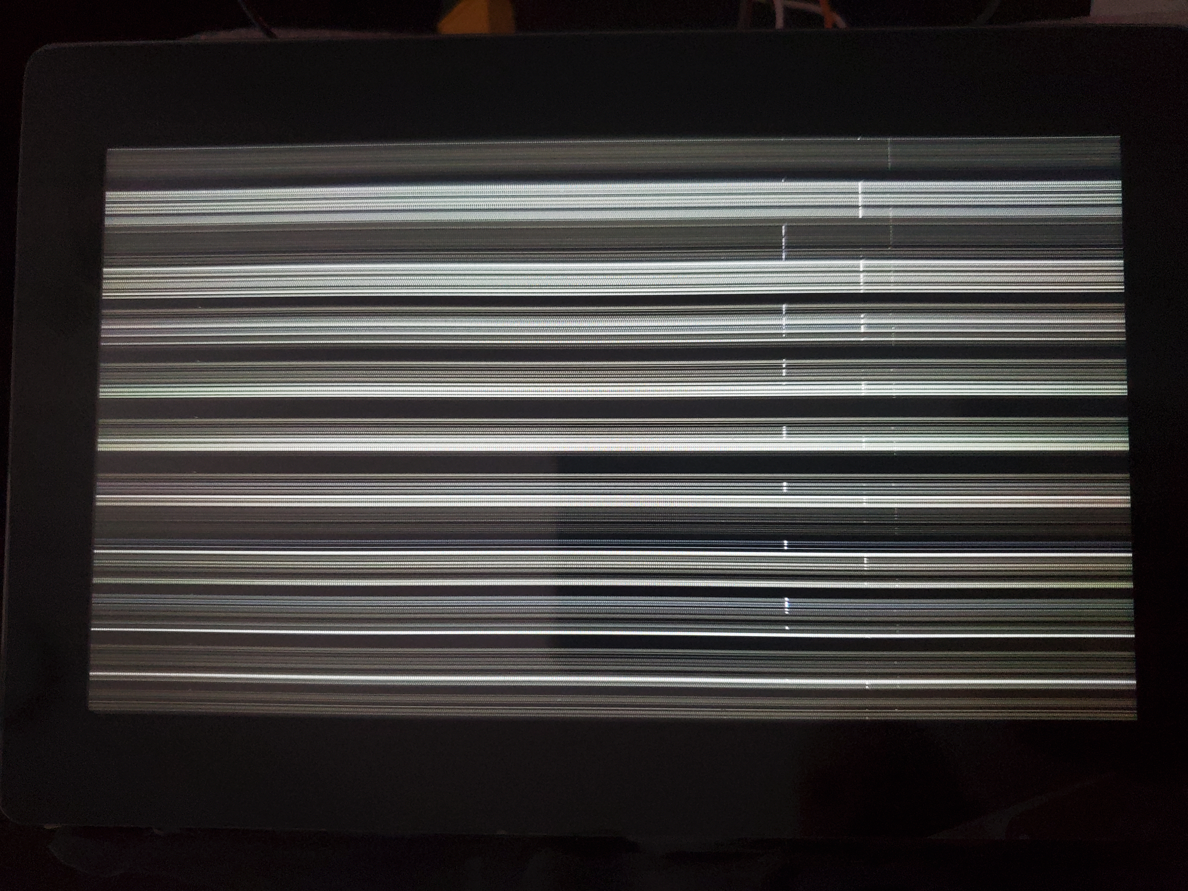

I have included the image of what I am getting on the display in hopes of someone possibly recognizing what is going on or can point me in the right direction. I have tried the example code from Matrix Orbital and also Rudolph's code and I am not having success with either, just the white horizontal lines. The lines are not static but jump around the display.
Raquel was assisting me and shared the updated parameters for the EVE4-70G which I am using:
DWIDTH = 1024;
DHEIGHT = 600;
PIXVOFFSET = 0;
PIXHOFFSET = 0;
HCYCLE = 1259;
HOFFSET = 85;
HSYNC0 = 37;
HSYNC1 = 40;
VCYCLE = 768;
VOFFSET = 16;
VSYNC0 = 13;
VSYNC1 = 20;
PCLK = 1;
SWIZZLE = 0;
PCLK_POL = 0;
HSIZE = 1024;
VSIZE = 600;
CSPREAD = 0;
DITHER = 1;

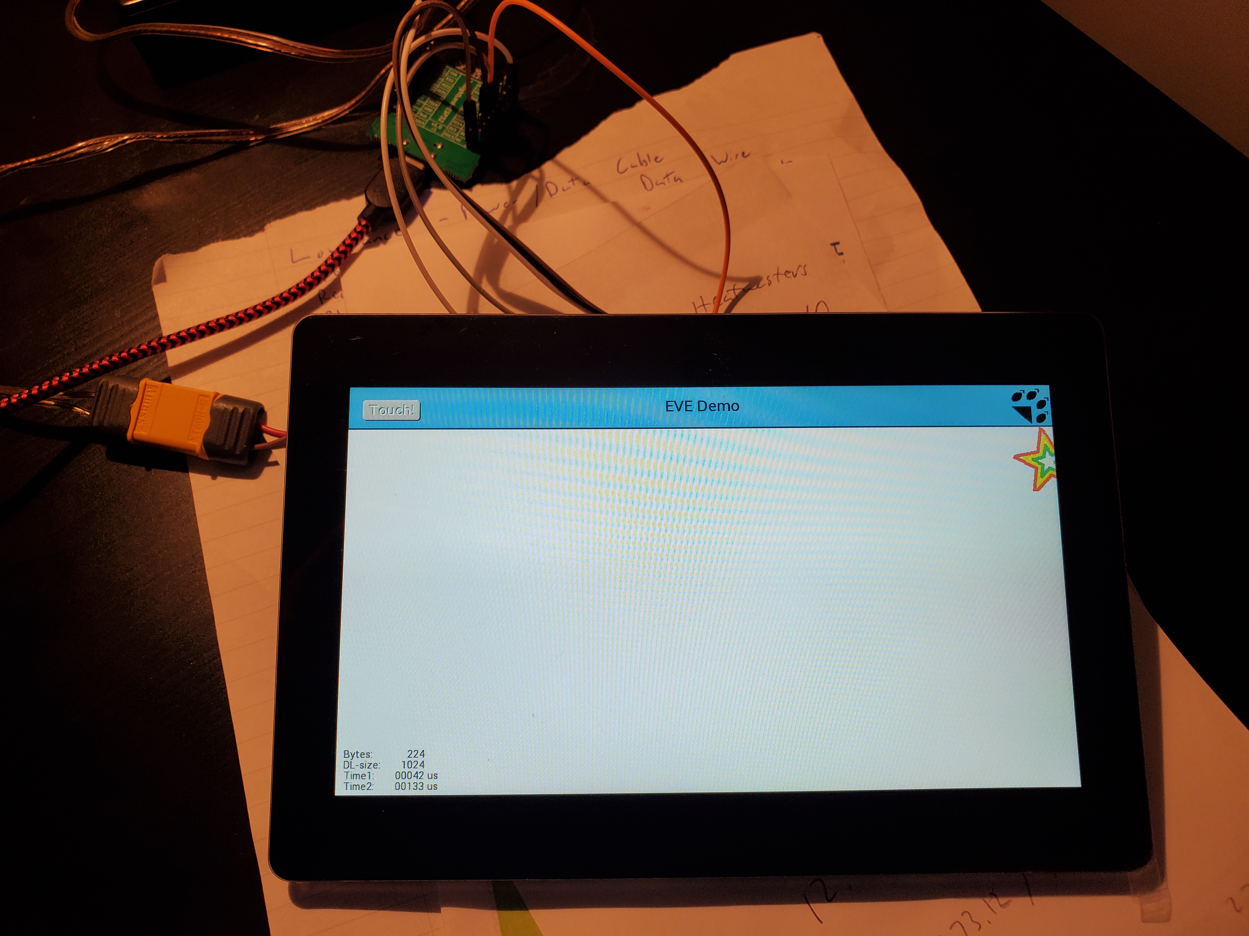

lazorramatrix
Posts: 11
Joined: Sat Feb 20, 2021 2:46 pm
Re: EVE4 Assistance
Post by lazorramatrix »
I'm not sure what the issue was before but the display is now working fine with the above parameters.
