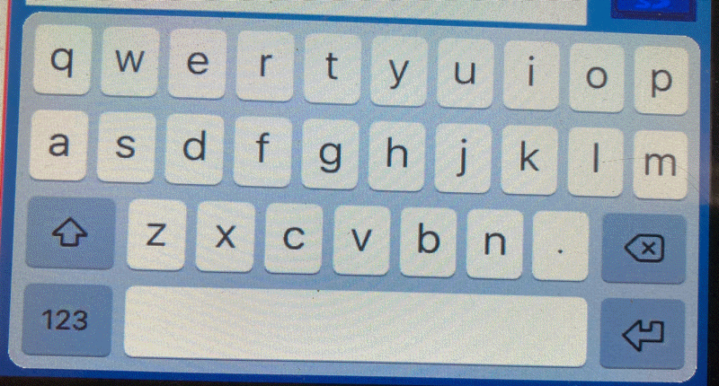

Now the problem:
I'm developing this on Linux. If I first convert the files using asset builder on Windows, then it works fine.
As Linux (Ubuntu) has an astcenc program which produces astc files, it would be nice to use it
and skip one step, starting from regular PNG files and converting them to .astc first, and then to
a .c, .h pair.
The format of these files is a bit similar to EVE asset builder format, there is a 16-byte header before the raw
data, which can be removed by reading the whole file from byte 16.
However, the output looks a bit scrambled although not completely random, so I suppose it's a matter of
using the right parameters.
Question:
Does anybody know detail about EVE astc format? Especially why it's different to
Linux' format?
Has anybody managed to use Linux' astcenc application to display bitmaps with EVE screen?
Thanks for any hint!
R
