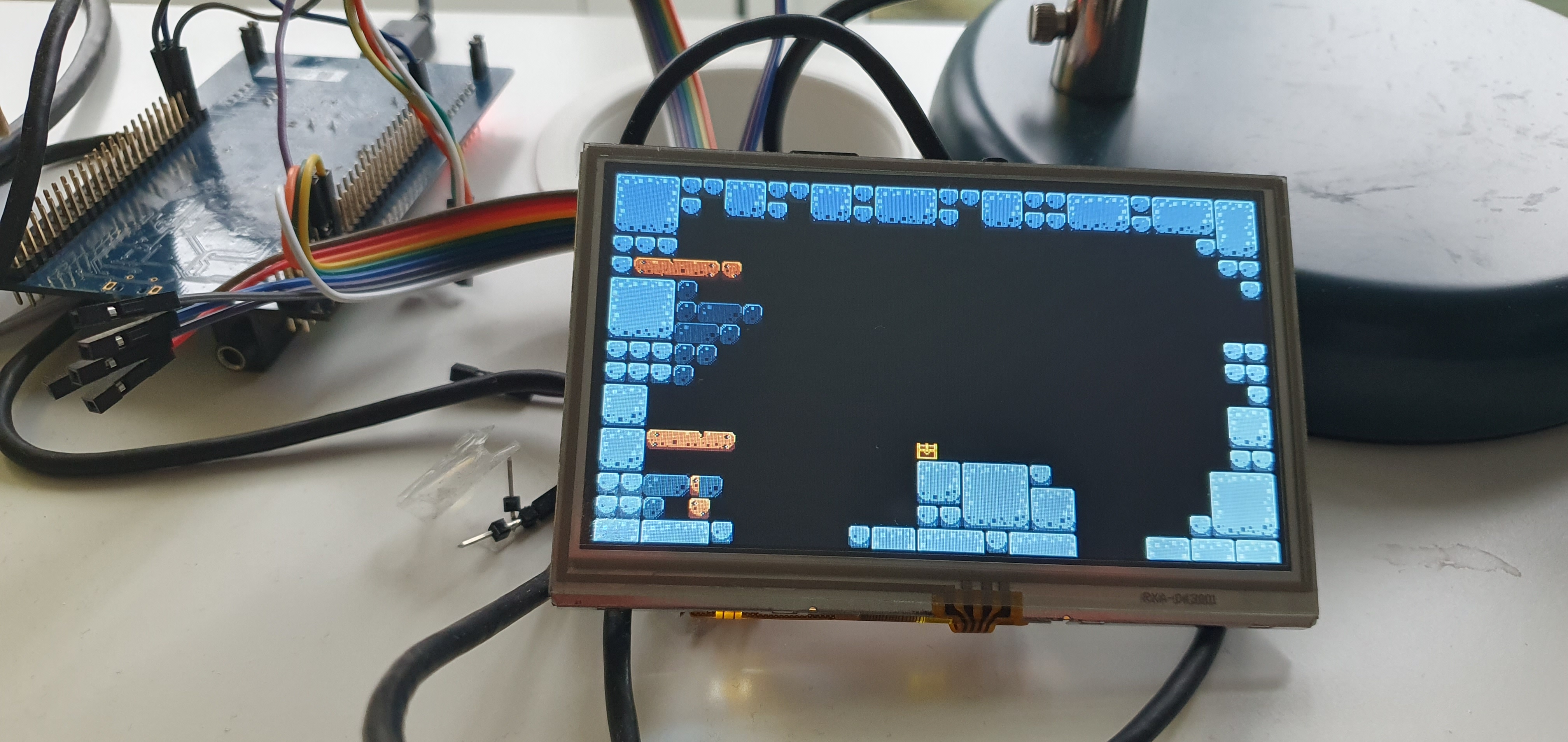

I have connected Gameduino 2 display to stm32f407 discovery board.
I am able to write text and bitmaps on the display, but I experience issue when trying to add more than 3 bitmaps at the time.
After some try and error it seems that I need to add some delay between each of the commands in the command list, otherwise nothing would
be displayed.
My plan is to try to make video game, and I am thinking on creating the background picture by using some tiles.
I have used EVE Asset Builder tool to convert 16x16.png file to an array and thereafter I have included array in my program and uploaded it to GRAM.
SPI connection on the discovery board is configured to 8MHz.
Bellow is example of the program which I have shortened in this case, but in reality I am sending many more BITMAP_SOURCE and VERTEX2F commands:
My impression is following, the more BITMAP_SOURCE and VERTEX2F commands I include in DrawBitmap3() function, the more delay I need to add in between.
Probably there is some other way to do this but I have not understand it yet.
I have attached 2 pictures. One is the tilemap which is converted to an array and another is how my display looks so far.
I hope that somebody might have some good suggestions on how this could be done.
Thanks in advance.
