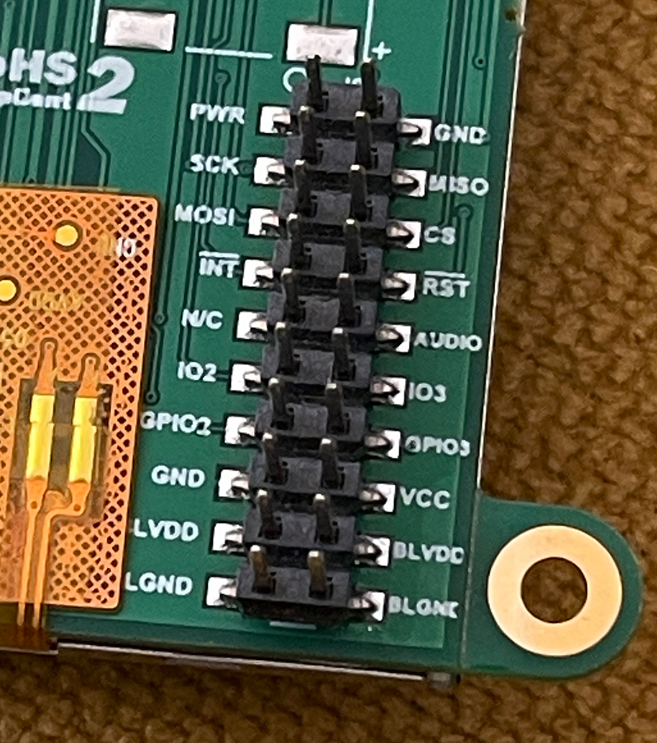

Pins in image
I can't find a description for the pinout above on https://www.matrixorbital.com/ftdi-eve/ ... ps-800480a
I understand the top 6 SPI pins. Curious about the bottom 14. And the difference between PWR and VCC in this case. I plugged in my matrix orbital display using FT81xMania+Teensy4 and it is blackout. I had it working fine with other BT81X screens. Probably just a basic mistake.
Thank you.
Re: Pinout description EVE3x43
Pin	Symbol	Type	Function
1	VCC		Power		3.3V or 5-15V
2	GND		Ground		Ground Connection
3	SCK		Input		SPI clock input
4	MISO		Input/output	SPI Single mode: SPI MISO output SPI Dual/Quad mode: SPI data line 1
5	MOSI		Input/output	SPI Single mode: SPI MISO input SPI Dual/Quad mode: SPI data line 0
6	CS		Input		SPI slave select input*
7	¯("INT" )	Open Drain Output	Interrupt to host**
8	RST		BT81x Reset pin
9	N/C		No connection	No connection
10	AUDIO		Output		Audio PWM out
11	IO2		Input/output	SPI Single/Dual mode: General purpose IO 0 SPI Quad mode: SPI data line 2
12	IO3		Input/output	SPI Single/Dual mode: General purpose IO 1 SPI Quad mode: SPI data line 3
13	GPIO2		Input/output	General purpose IO 2
14	GPIO3		Input/output	General purpose IO 3
15	GND		Ground	Ground connection
16	VCC		Power	Logic Voltage (3.3V or 5-15V)
17	BLVDD		VDD		No Connect (Optional Backlight Voltage)
18	BLVDD		VDD		No Connect (Optional Backlight Voltage)
19	BLGND		Ground	Ground
20	BLGND		Ground	Ground

nsbzero
Joined: Thu Jun 15, 2023 2:20 pm
Post by nsbzero »
Since the OP was a question about the EVE3x-43A-IPS-800480A, I have a couple of follow-up questions:
1) The timing information mentioned above seems to be for a 480x272 display, whereas the EVE3x-43A-IPS-800480A is an 800x480 display. Where can I find the correct timing for this display?
2) Are J3 (FPC) and J6 (Pin Header) meant to be equivalent? It seems mostly so, but the SCK line on J6 is not connected to SCK on the BT815, which of course makes it not very useful. SCK on J6 is connected to R19, which is connected to the BT815, but this was shipped unpopulated. Is there a reason for this?
3) How would one supply independent backlight voltage on this board? Other posts here have referenced depopulating R1 and populating R4 with a 0-ohm, but my board shipped with neither of these populated, and R1 is attached to the SCK line on the FPC, so I am guessing that advice was for a different product. What is needed for this board?
