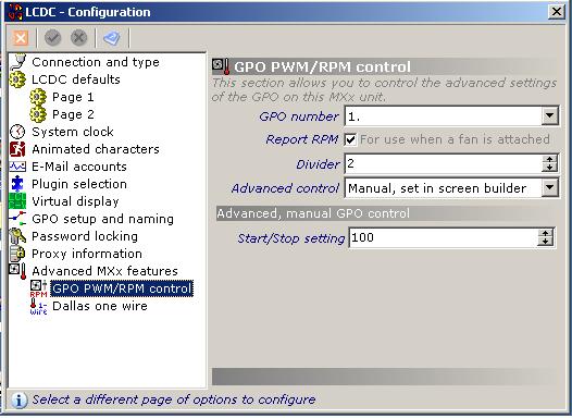

Hi Aaron,
First off, you need the jumper on the two left pins to have control with higher power. When you have the jumper on the two left pins, you have the GPOs powered at 12V 1000mA. When you have the jumper on the two right pins, you have the GPOs at 5V and 1000mA.
The standard molex floppy power connector from your power supply is the correct power cable. If you didn't have the right cable, the display wouldn't have powered up.
To control the fans manually, you must do a couple configurations. I have attached a picture illustrating the configuration. You must do the following configuration for each fan or GPO you want to use.
