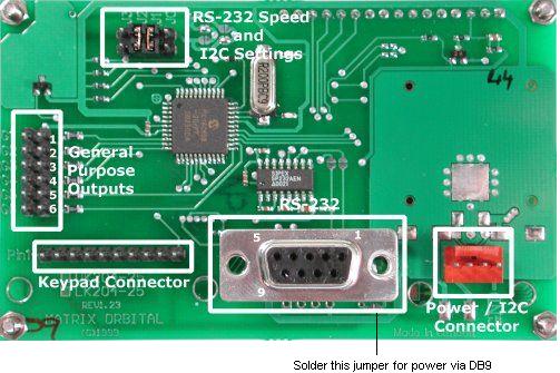

LK204-25. I want to supply the power via the RS232 connector. Do a need to apply a jumper? The LK162-12 manual shows a jumper, but the LK204 manual does not.

Hi pieter,
I have attached an image of where the jumper is for the LK204-25. If you solder the jumper it will allow you to provide power via DB9.

Thanks, Jon. This is the right trick and my display is working now.
