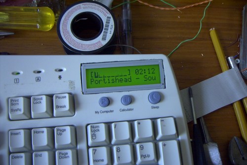

Unit: LK162-12
Case: Microsoft Internet Keyboard Pro
Difficulty: Medium
Other: It's a tight fit, and to make room inside the keyboard, I had to remove a screw column, reposition a few capacitors on the keyboard's controller, and file down the chassis for those three Internet buttons a bit. To scale down the display itself, I removed all of it's headers and connectors, and seperated the serial backpack from the main display, reconnecting it near the center of the keyboard with some ribbon cable. I also dremelled off the display PCB's top-right corner, and took two or three millimeters off the top edge(It's THAT tight a fit). Everything is powered off the keyboard's built-in USB hub via a stripped down USB-to-Serial adapter cable embedded inside.
Hey, I finally got around to taking an internal picture. From left to right, you see the USB/Serial adapter, the LCD's Serial backback, and the keyboard's own controller.
Materials Needed: Phillips screwdriver, Dremel tool with drilling/cutting bits, file, soldering iron, hot glue gun, USB-to-Serial adapter(PL2303 chipset based), wire & drive ribbon cable.

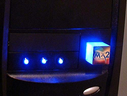

Unit: LK204-25PC
Case: Chieftec Dragon Big Tower
Difficulty: Medium
Other: Connected blacklight cc, blue cc, keypad lighting and casebadge lighting to GPOs.
I separated the pcbs and mounted the controller card on the Digital Doc 5 and the display card in the front door of the case.
Materials needed: Dremel with various accessories, epoxy glue, screws, stand-offs, pcb-making equipment (for the keypad), other bits and pieces.

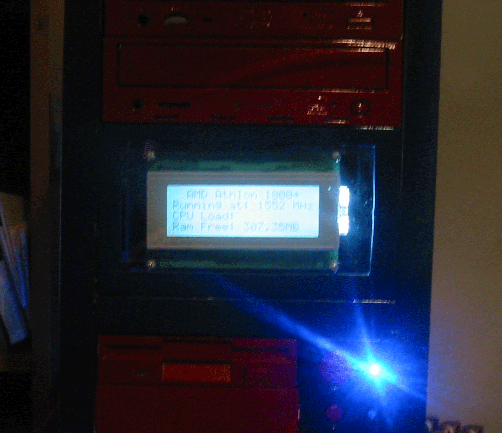

LCD on Project Crucial:
Case: Modified mid-tower, unknown brand
Difficulty: easy-medium
Other notes: Fairly easy, drilled the hole with drill, used scroll saw to cut out a square then filed it down to exact. The LCD doesn't work, it is broken right now, but that will change. I plugged in power wrong.

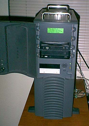

Unit: BLC2041
Case: Antec SX1040b
Difficutly: Easy
Other: Damn nice LCD if i do say so myself

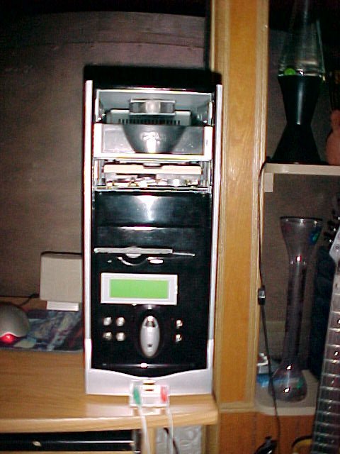

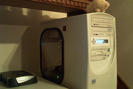

Unit: LK204-25PC
Case: Enlight 7237
Difficulty: Easy
I am definitly not the master at measuring things...
nor the painting and not scratching of things...
looking at that first pic makes me want to repaint the whole case...
anyways what i did... was take 2 drive blanking things (my last two... hope i dont screw up)
cut.. glue in plexi and mount....
i dont really like it... but im not gonna worry about it until i get a new case

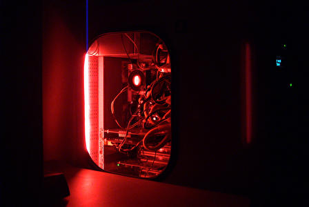

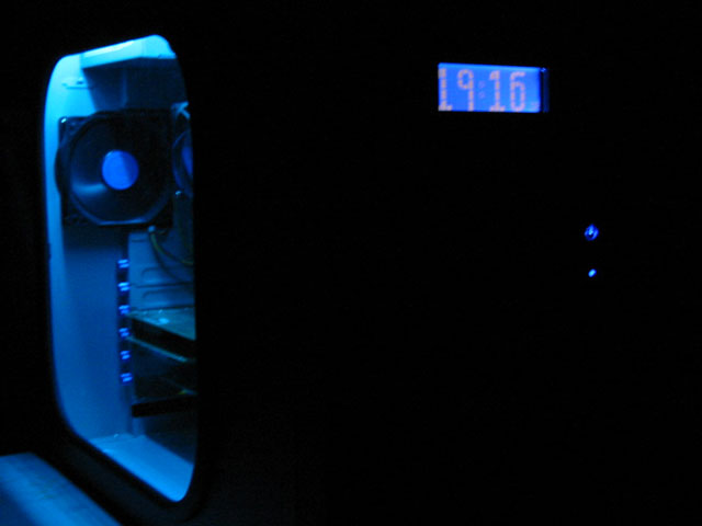

Unit: BVK202A-4BR
Case: Generic mid tower
Difficulty: Medium (I had to relocate my cathode switch to my case door which meant drilling, then the plug on the cathode broke so I had to solder on the wires to the switch, and now my power supply fan makes a loud grinding noise for some unknown reason:) )
Other: I like the display alot but I just wish I could get it and the software to act right so I can get it to display what I want it to. Well here are the pics
List of tools: screwdriver(flat and philips)

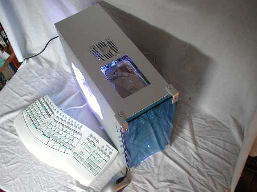

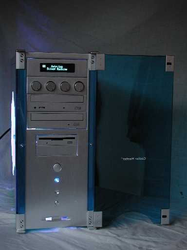

bUnit: VK202-25
Case: Coolermaster ATC 210
Difficulty: Moderate
Here's my latest project. The VFD is mounted via 4 bolts glued to the back of the faceplate.
Currently this is aircooled...next stop watercooling.
l8r,
Detritus
{hosting pics}

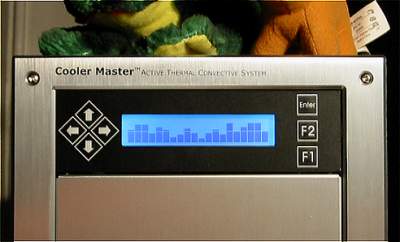

Hey all
This is our music PC in the shop , currently hooked up to 7 demo speaker systems through a switch box. To finish the job off , we fitted a BVF-2041 - not really anything original there, but the full pc system certainly grabs some attention. The colour scheme is loosely modelled on those classic jukeboxes with the coloured tubes around them !
Thanks !

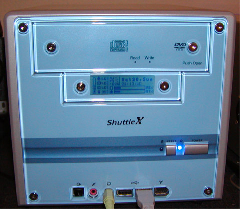

Unit: GLK12232-25-SM
Case: Shuttle SS51G
Difficulty: Medium
Since it is taller then 3.5 bay, need some case modification.
CD Drive's bottom plate must be removed or cut.
Toggle power switch is installed using original bolt hole. May be I will change them to two momentary switchs that work as keypads!
Case: Shuttle SS51G
Difficulty: Medium
