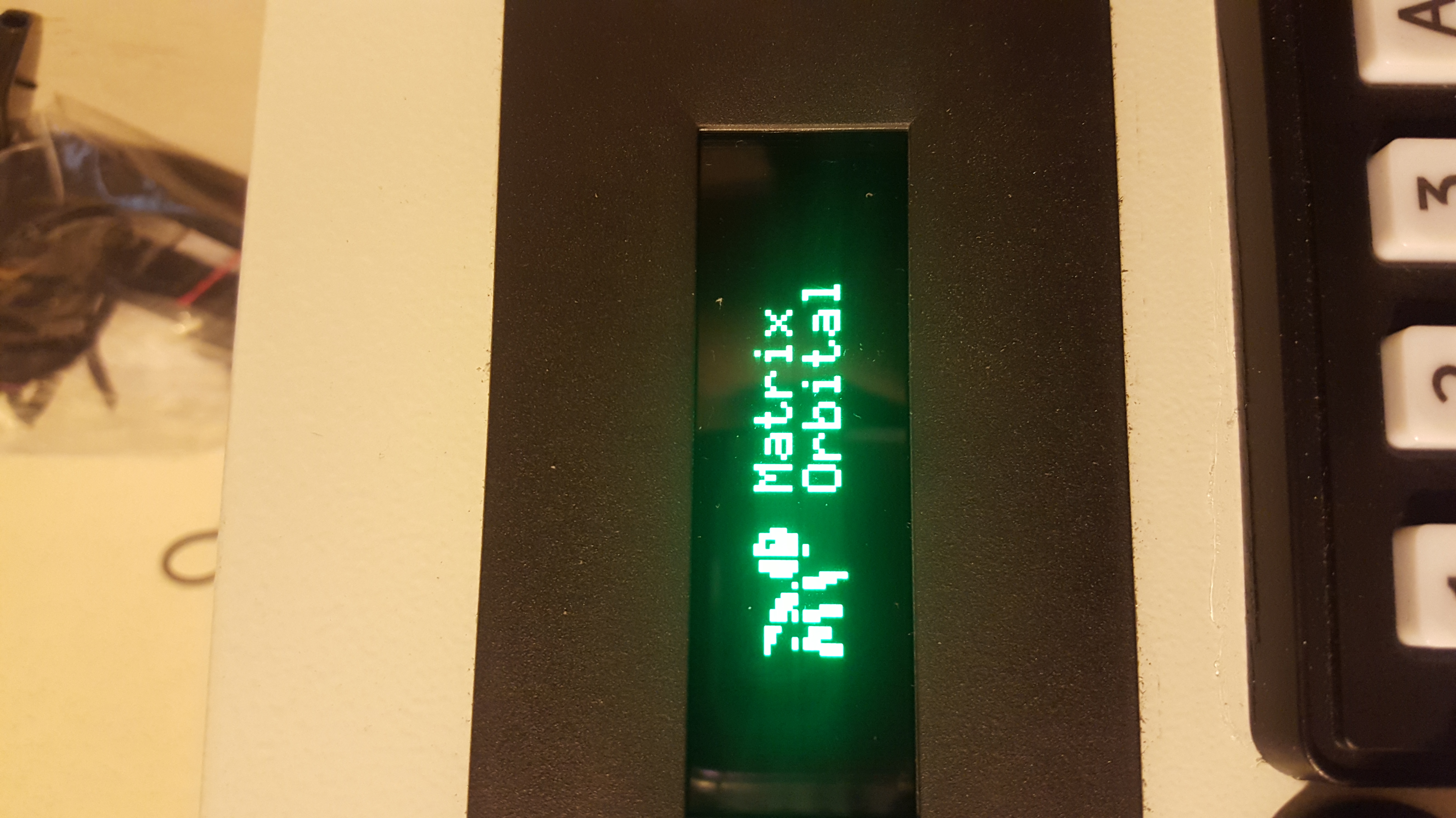

- Posts: 4
- Joined: Fri Oct 05, 2018 2:55 pm
Re: Bezel and OK204-25
Thanks for the reply, I made some changes to the bezel, it was already glued to the cabinet :(
But the final work has no problems.
![Image]()
- 20181011_223309.jpg (4.54 MiB) Viewed 36149 times
- Posts: 247
Hi Luis,
I'm glad to see you were able to resolve the issue in the end.
The bezel looks really good from what I can see!
